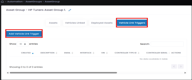

| 2. | Click the Asset Group you would like to link to corresponding vehicle. |
| 3. | Select Vehicles Link Triggers, then Add Vehicle Link Trigger. |

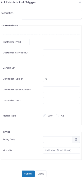

| 4. | The below Add Vehicle Link Trigger window will appear. This window is where you need to specify what criteria your customers need to match in order to automatically deploy that asset group. |
NOTE: All vehicle link triggers need to match for asset to deploy.
NOTE: It is HIGHLY recommended to use both the "Controller Type ID" & "Controller OS ID" when setting the vehicle link trigger criteria.
| 5. | Click Submit. |

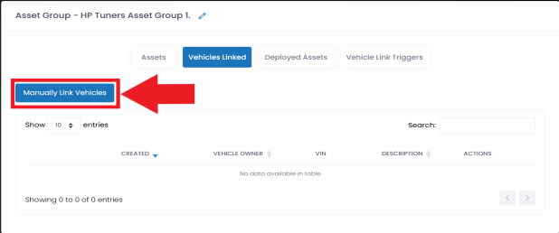

| 6. | Once the customer reads/logs and sync's a vehicle matching all triggers, the asset will automatically be sent to the customer/end user. |
NOTE: If you need to manually link a vehicle to an asset group, click Manually Link Vehicles to select the vehicle you would like to link.
