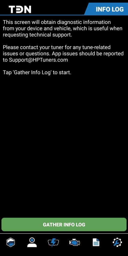

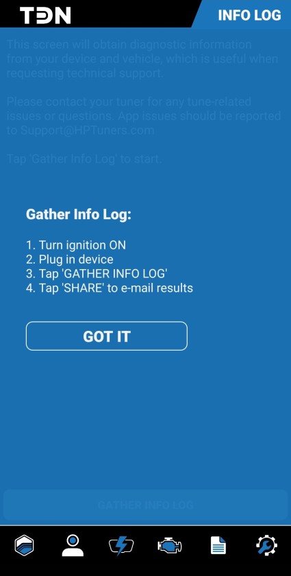

Tap the TOOLS icon to open the Setup / Tools Menu. |
4.
Select Gather Info Log for Tech Support. Info Log Screen appears. |
5.

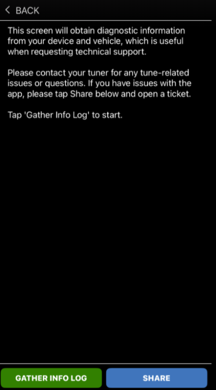

Tap the GATHER INFO LOG button. The app will begin gathering the Info Log. |
6.
When the app has finished gathering the Info Log, tap SHARE to email the log to customer support. |
a.
You can share your infolog via email by selecting Share via Email/Messaging. |
