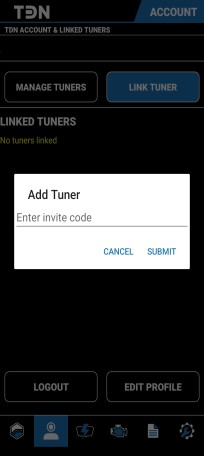

3.
Tap the LINK TUNER tab. Enter the invite code and select SUBMIT. |
4.
The below screen will appear, select OK. |

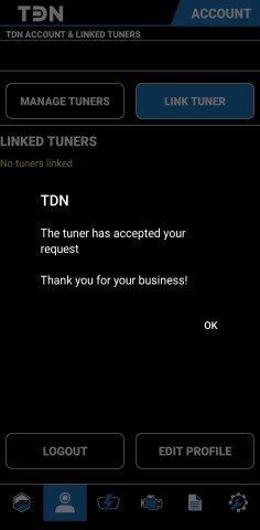

5.
If the tuner automatically accepts requests to join their network, you should receive a confirmation popup almost immediately. Otherwise, you will have to wait for the tuner to manually approve your request. |

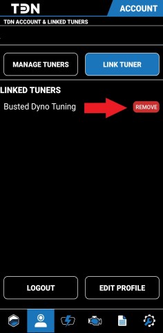

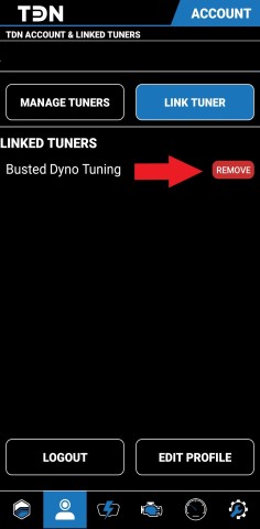

6.
Once the tuner has accepted your request, they will appear under the LINKED TUNERS list. |
8.
If you no longer work with any tuners under your LINKED TUNERS list, select REMOVE next to the tuners name on the right. |
